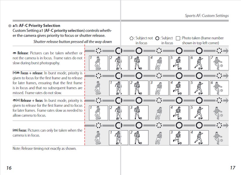

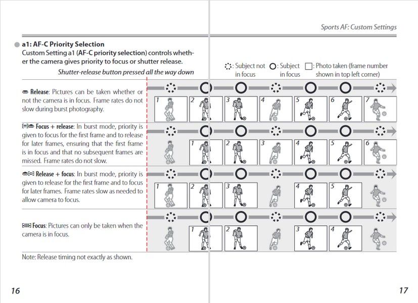

unfortunately r+f and f+r don't work with bbf, only shutter button mode. I think Cindy switches between shutter and bb but I get myself all confused, lol. I have to stick with bbf full time.
