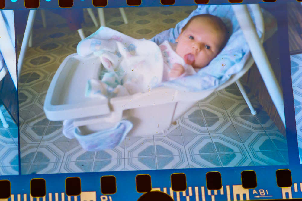

My wife found some of our old 35mm film negatives today.
I would like to convert some of them to digital.
I watched some youtube videos and did some googling, I learnt that you can do it with a yoghurt container and phone camera, or I can buy a gizmo off ebay to do it.
Can I use my D7100 and a macro lens while backlighting the negatives with a lightbox ?
Does anyone have any experience with this ? Any help would be appreciated.
Matt Day has a few great videos on this topic. I'd use your D7100 WAY before a tiny phone sensor for scanning
