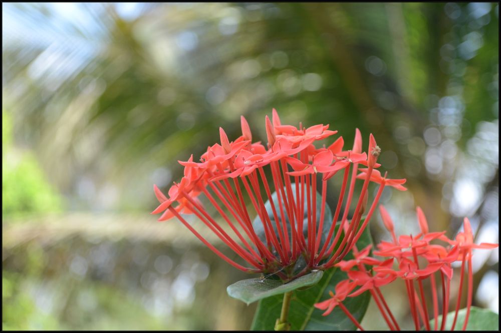

MaharajanM
How can I sharpen the subject further?
Make - NIKON CORPORATION
Model - NIKON D5100
Orientation - Top left
XResolution - 96
YResolution - 96
ResolutionUnit - Inch
Software - Ver.1.01
DateTime - 2023:04:09 11:12:49
YCbCrPositioning - Co-Sited
Exif-IFD-Offset - 228
GPS-IFD-Offset - 36868
ExposureTime - 1/800 seconds
FNumber - 5.00
ExposureProgram - Aperture priority
ISOSpeedRatings - 400
ExifVersion - 0230
DateTimeOriginal - 2023:04:09 11:12:49
DateTimeDigitized - 2023:04:09 11:12:49
ComponentsConfiguration - YCbCr
CompressedBitsPerPixel - 4 (bits/pixel)
ExposureBiasValue - 0.00
MaxApertureValue - F 5.10
MeteringMode - Spot
LightSource - Auto
Flash - Not fired
FocalLength - 38.00 mm
MakerNote-IFD-Offset - 876
UserComment -
SubsecTime - 70
SubsecTimeOriginal - 70
SubsecTimeDigitized - 70
FlashPixVersion - 0100
ColorSpace - sRGB
ExifImageWidth - 1000
ExifImageHeight - 662
InteroperabilityOffset - 36836
SensingMethod - One-chip color area sensor
FileSource - DSC - Digital still camera
SceneType - A directly photographed image
CustomRendered - Normal process
ExposureMode - Auto
White Balance - Auto
DigitalZoomRatio - 1 x
FocalLengthIn35mmFilm - 57 mm
SceneCaptureType - Standard
GainControl - Low gain up
Contrast - Normal
Saturation - Normal
Sharpness - Normal
SubjectDistanceRange - Unknown
GPS information: -
GPSVersionID - 2.3.0.0
Maker Note (Vendor): -
Data version - 0120 (808530480)
ISO Setting - 400
Image Quality - FINE
White Balance - AUTO
Focus Mode - AF-S
Flash Setting - NORMAL
Flash Mode -
White Balance Adjustment - 0
White Balance RB - 742
Exposure Difference - 0.0
Thumbnail IFD offset - 11422
Flash Compensation - 67072
ISO 2 - 400
Image Boundary - 0 0 28686 36873
Serial number - 8235599
Colorspace - Unknown (0)
Active D-Lighting - Off
Picture control - Version - 0100
Picture control - Name - STANDARD
Picture control - Base - STANDARD
Picture control - Adjust - Default
Picture control - Quick Adjust - Normal
Picture control - Sharpness - +3
Picture control - Contrast - Normal
Picture control - Brightness - Normal
Picture control - Saturation - Normal
Picture control - Hue Adjustment - Normal
ISO 3 - 400
ISO Expansion - Off
HDR info - Version - 0100
HDR - Off
HDR Level - Auto
Lens type - G VR
Lens - 18.00
Flash Used - Not fired
Shooting Mode - 0
Noise Reduction - OFF
Lens info - AF-S DX VR Zoom-Nikkor 18-55mm f/3.5-5.6G
Total pictures - 6988
Vari Program - Not defined
AF info 2 - version - 0100
Contrast Detect AF - Off
Thumbnail: -
Compression - 6 (JPG)
XResolution - 300
YResolution - 300
JpegIFOffset - 36996
JpegIFByteCount - 9018

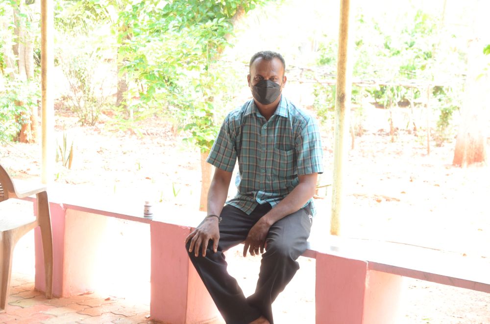

MaharajanM
here how can I get the better contrast for both the subject and background with out using Active D-Lighting mode? Any steps to follow?
Model - NIKON D5100
XResolution - 300
YResolution - 300
Software - Ver.1.01
DateTime - 2023:04:09 11:02:02
GPS-IFD-Offset - 37032
ExposureTime - 1/30 seconds
FNumber - 7.10
ExifVersion - 0230
DateTimeOriginal - 2023:04:09 11:02:02
DateTimeDigitized - 2023:04:09 11:02:02
MaxApertureValue - F 5.66
MeteringMode - Spot
LightSource - Auto
Flash - Not fired
FocalLength - 48.00 mm
UserComment -
SubsecTime - 70
ColorSpace - sRGB
ExifImageWidth - 3696
ExifImageHeight - 2448
InteroperabilityOffset - 37000
ExposureMode - Auto
FocalLengthIn35mmFilm - 72 mm
Contrast - Normal
Saturation - Normal
Sharpness - Normal
GPS information: -
ISO Setting - 400
Focus Mode - AF-S
Flash Mode -
ISO 2 - 400
ISO 3 - 400
ISO Expansion - Off
HDR - Off
HDR Level - Auto
Lens type - G VR
Lens - 18.00
Shooting Mode - 0
Total pictures - 6952
Thumbnail: -
XResolution - 300
YResolution - 300
JpegIFOffset - 37160
JpegIFByteCount - 8547

Are you shooting jpegs? If so set your sharpness to +7 and saturation to +1 for Standard Picture Profile as a starting point.
See this post for where to change those settings. https://nikonites.com/forum/threads/your-jpeg-settings.38295/post-595984
D5100 reference manual here. https://downloadcenter.nikonimglib.com/en/products/23/D5100.html
You second picture is overexposed both the subject and background. Sometimes when starting out it is helpful to shot a shot in Auto mode and check which settings the camera would choose. I see you shot this with spot metering try either center weighted or matrix. Was the area covered? With high contrast scenes sometime it is not possible to keep the background from blowing out without adding light to the subject. This can sometimes be accomplished by using fill flash.

Thanks for the suggestion, I had set the sharpness to +7 and Saturation to +1 and untouched remaining setting for the Standard profile. Let me shoot in this setting and update
Fred Kingston_RIP

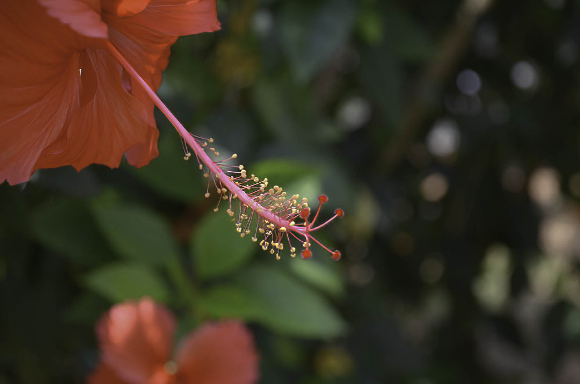

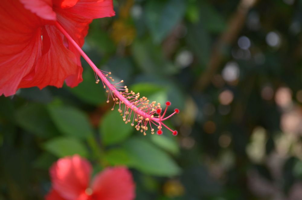

You can sharpen the images in post processing a bit... here's working with your JPG image... there's more range with a RAW file... I couldn't do much with your CONTRAST image because the JPG has limited range and I didn't have a RAW file... It's way over exposed and there's loss of detail... Normally I'd expose that image normally for the background then mask the subject and bring up the exposure there...
MaharajanM
Yes I had used the spot metering here, let me try with Matrix metering. Unfortunately for me only Single-point AF Area Mode is working now, Auto Focus is not working for other AF-Area Modes
Fred Kingston_RIP
Thanks Fred. How to do that "Normally I'd expose that image normally for the background then mask the subject and bring up the exposure there.."
As mentioned, Back-lite scenes like yours, I switch to Matrix metering.... The majority of my stuff is done with spot metering, but you need to be able to switch metering modes when lighting changes...

Fred how do you use spot metering? My introduction to spot was from a wedding photographer so for the highlights (don't over expose the dress). How I used it was to meter both the highlights and shadow and set accordingly, saving the highlights as much as possible. Mostly now use matrix and some times highlight-weighted on the D810.
This is a difficult photo situation. I'd move the focus point off the subject's shirt or pants to something outside in the brightness. This will cause the camera to use the focus point you select for its metering calculations and lessen the intensity of light outside of the porch. The subject may then be in darkness, but you'll still have better balance. You might also try firing the flash to equalize the lighting.
