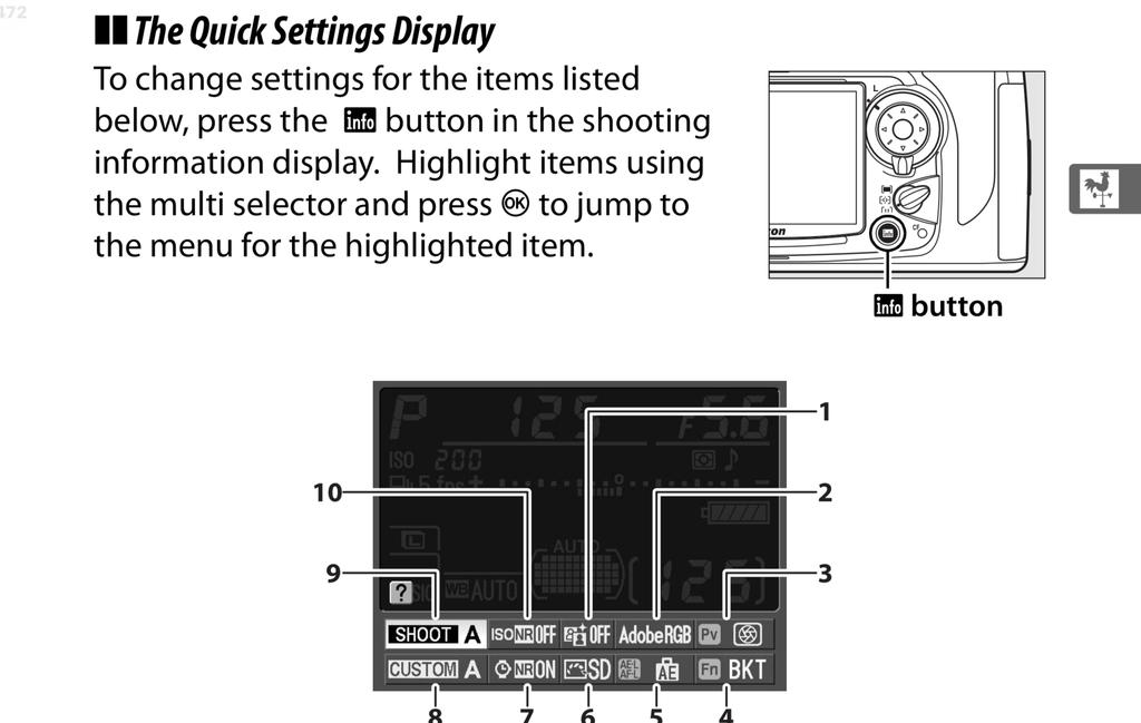

Does the info button work on the back of the camera? If so, that gets you to the quick settings screen, which is a short-cut to selected settings in the menu. If the buttons have a mind of their own because the electronics are shot, then it may not be worth repairing if it can be repaired even. Anyway, give this a shot and see if you can get into the menus to make changes.
