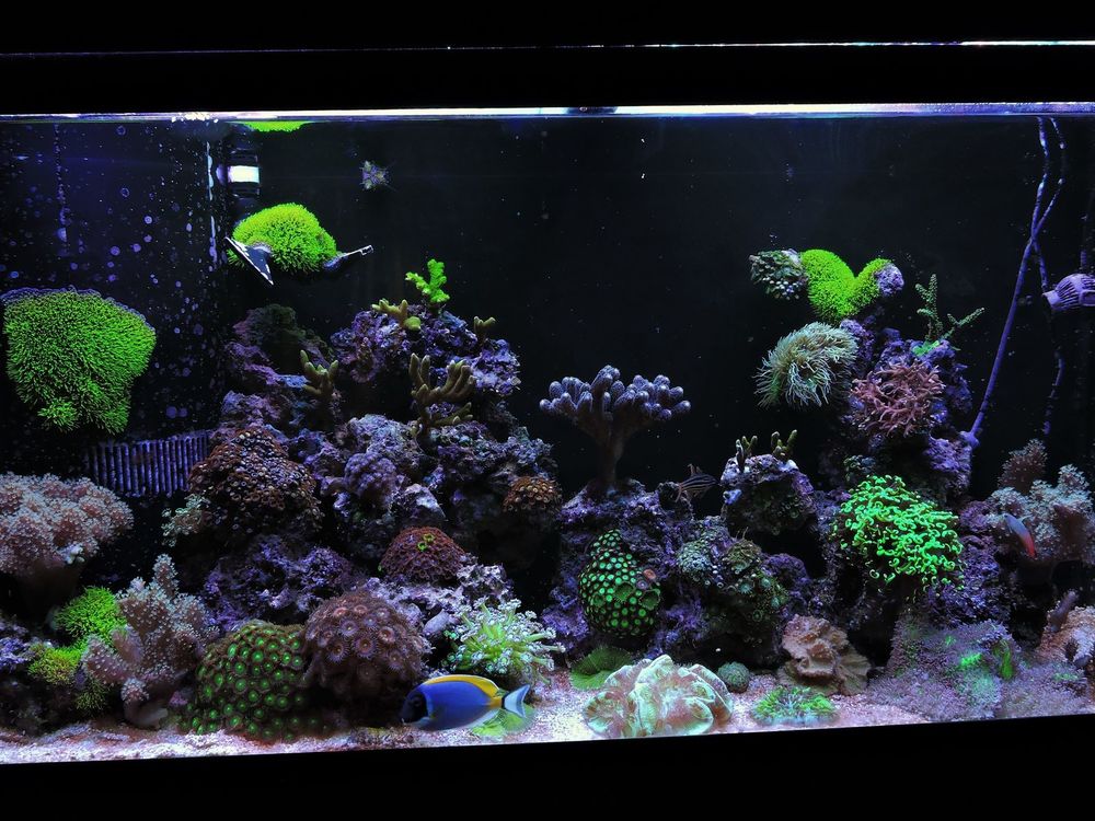

This is a tank shot with my p600 which was pretty good.
