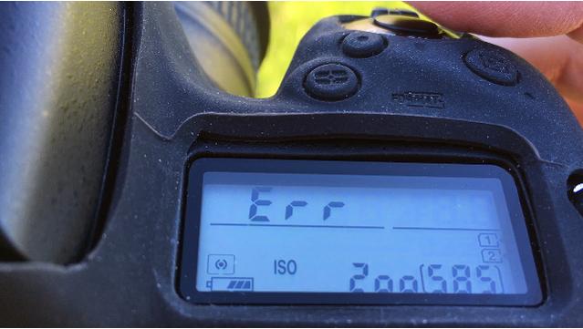

I am still experiencing the shutter error, but it's happening a little differently now. Initially as I started to press the shutter button, I could see the shutter speed jump up to 1/4000" while flashing (meaning the shutter speed is too high). If I stopped and didn't actuate the shutter, the shutter speed would return to its normal reading. In reality, my shutter speed was always below 1/4000" so I've been leaning towards the cause as being a software glitch. At the beginning, since I didn't realize it was happening, I'd see the shutter speed jump up just as I pressed the button. So I started to keep watch for it and was able to keep it from happening.
The thing is...now the shutter speed no longer jumps up to 1/4000" when the ERR happens so my guess is now the shutter is actually beginning to fail. However, I have yet to have it happen while I'm in manual mode. :confused:
Here is a screen shot taken from a video I recorded. I'm holding off on sending mine in because I'm afraid I will be in the same boat as @Blacktop where this won't be fixed even if the shutter is replaced. I'm definitely leaning towards there being a cause behind the shutter failure but am trying to document everything. Unfortunately I waited too long before trying to get a video of it for Nikon to review because I can't get it to show the shutter speed jumping up high like it did EVERY time it happened. :(
hark
Just want to update with the latest on the shutter err. I decided to hold off until it happened in total Manual Mode (without Auto ISO)--which it finally did. So I sent Nikon a message asking if the software can be completely erased as I am leaning towards this being a software issue. I made it clear that I wasn't asking about an update to the firmware. The Nikon rep said there isn't any way to remove the software. Plus...when doing a camera body reset, it DOESN'T reset the software. That only resets the menus.
Since this only happens on the first shutter actuation of the day, I am holding off on doing anything. From what I've read online, I'm not the only one with this issue. Although mine is one of the cameras that is covered under the shutter recall, I honestly don't think changing out the shutter will end the issue. So for now I will simply keep using it until the shutter completely fails. I even had two times when the shutter DIDN'T fail on the first shutter actuation, but otherwise it happens every time only on the first actuation of the day. If I turn it off for a short time then turn it back on again, it doesn't happen.
By the way, the original guy who answered my Nikon questions doesn't appear to work there anymore. When this new guy asked for a sample photo, his comment was, 'it's an underexposed image.' It was a totally black image. So I uploaded the image that immediately followed the shutter err image (which had the exact same EXIF). Of course he had to correct himself. My conversation with this guy was still in the same thread as the discussion with the first guy. Obviously this guy didn't bother to review the previously submitted images as well as any comments by the first Nikon rep.
