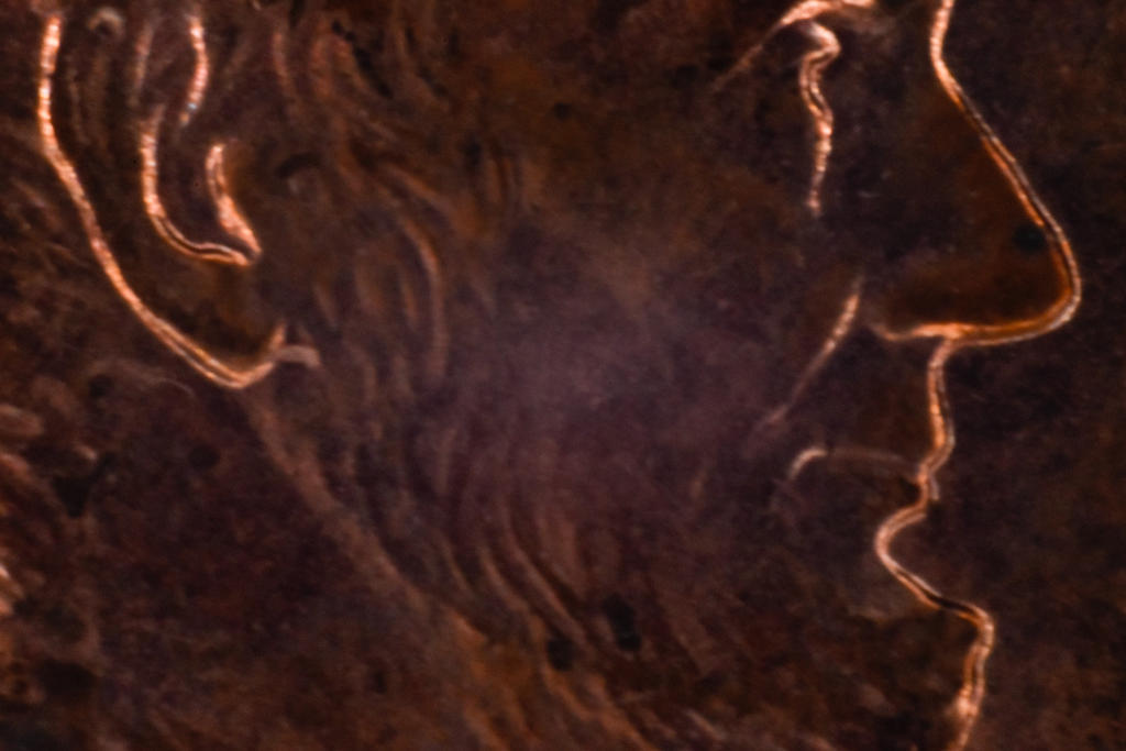

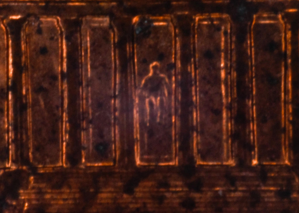

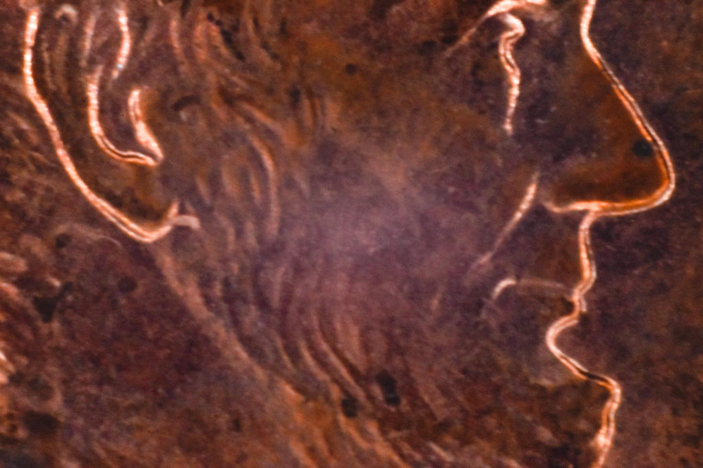

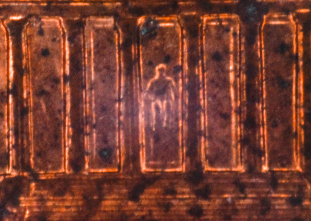

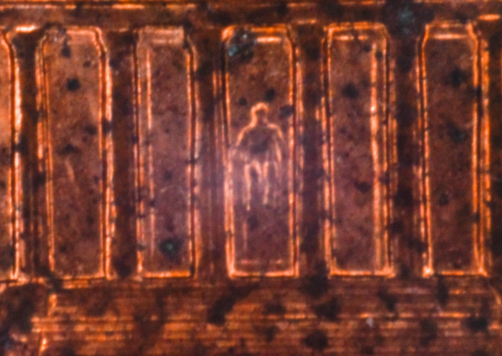

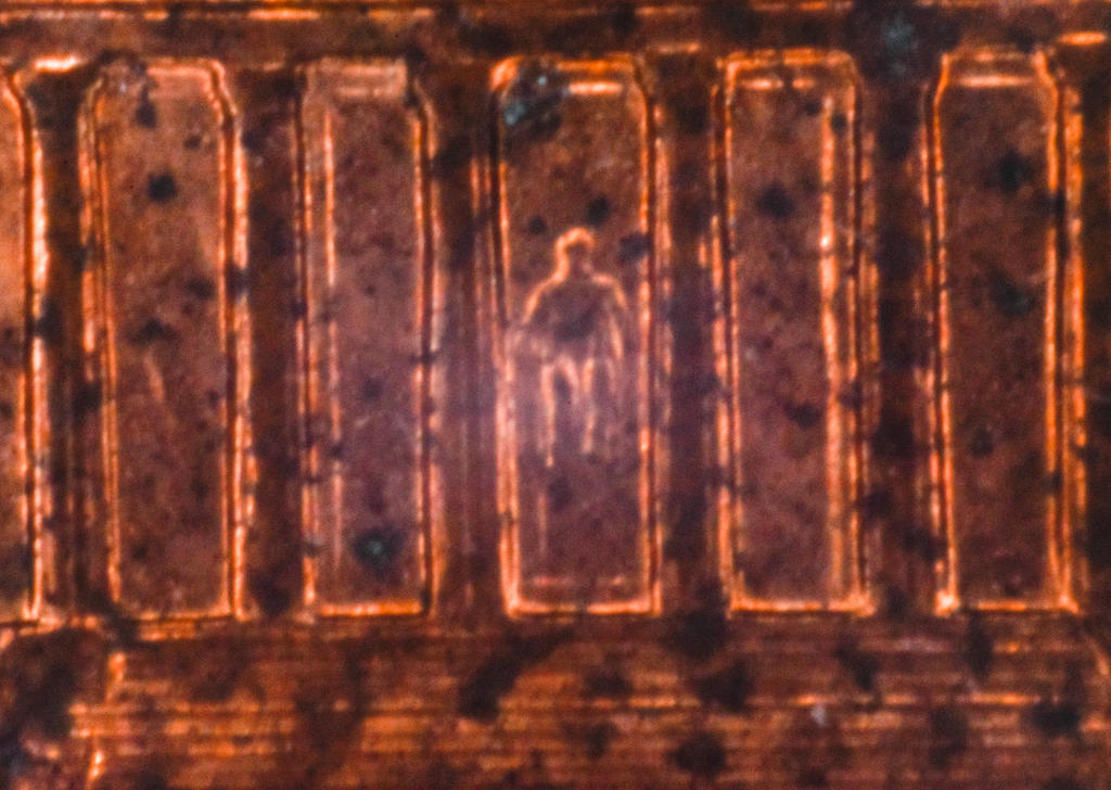

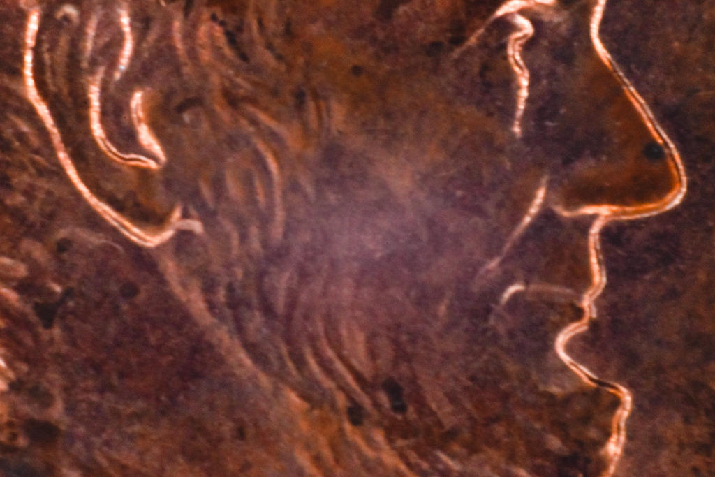

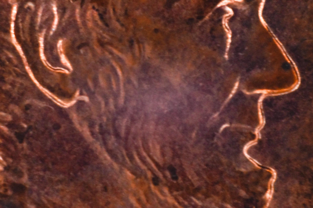

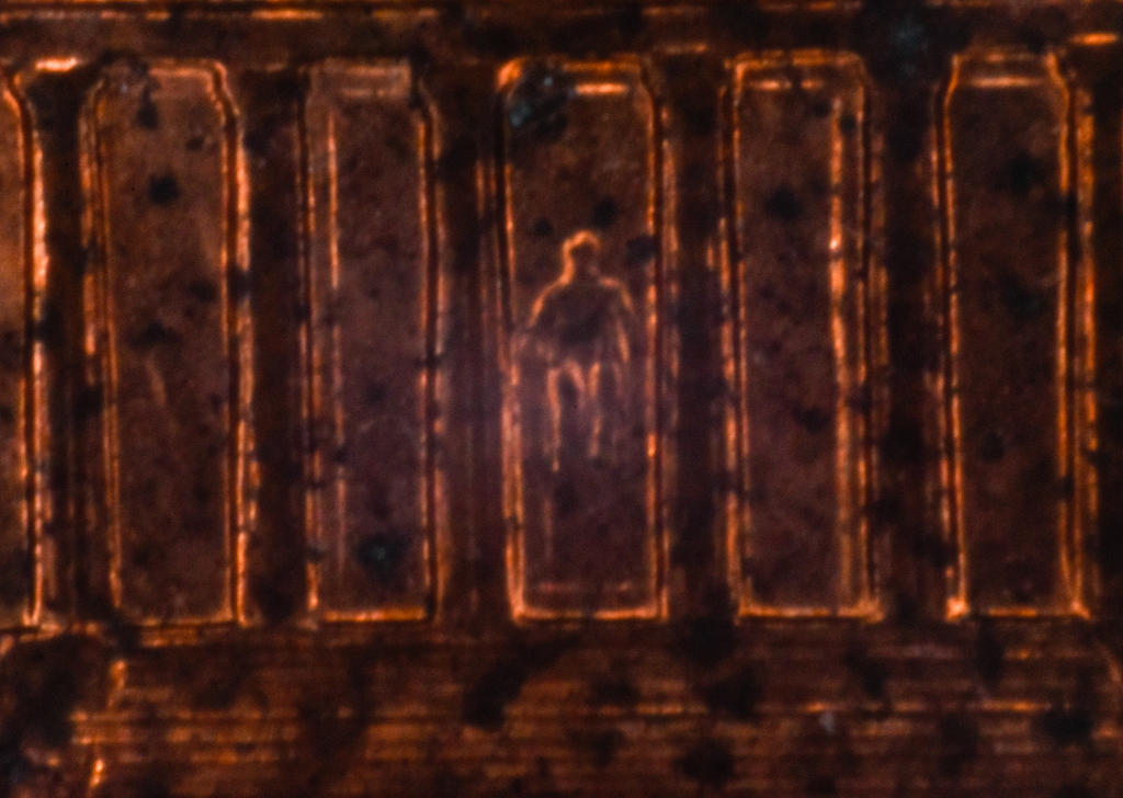

3. I don't know if they make ring lights for reversed mount lenses. My own guess is "no", but I didn't look online. What I did do though is take my current ring light and attached it to my reverse mounted 18-55mm kit lens with a simple rubber band. (I didn't use my macro 40mm lens because I know you don't have one.)
Here's are two sample shots of a penny I just took with that setup. These are handheld, 1/40th second, ISO 1600, f/5.6, Nikon D5500. All room lights were off, these are just with the lens mounted ring light. Shots were in .jpeg, and I just chose "Auto" in Lightroom as processing:
With a little increase in exposure, they look like this:
Not a very clean penny obviously, but at least you can tell what a reverse mount with a ring light can do to something that small (how often do you see the seated Lincoln figure on the back of a penny?) I wouldn't necessarily use it for serious macro work, but I think it's certainly usable for just playing around. Especially if I was looking for a very inexpensive option.

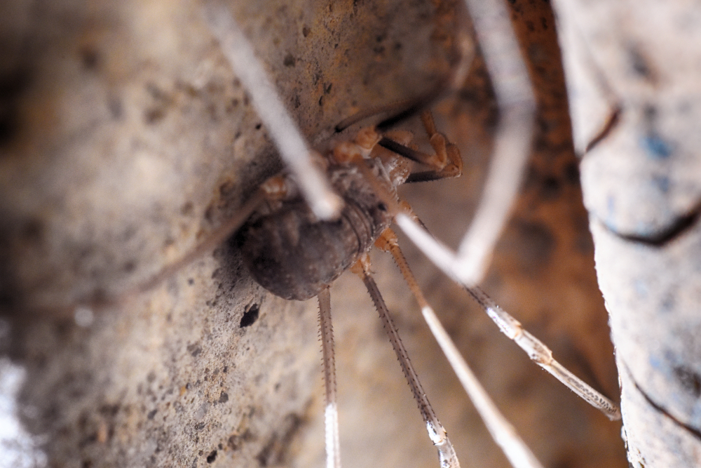

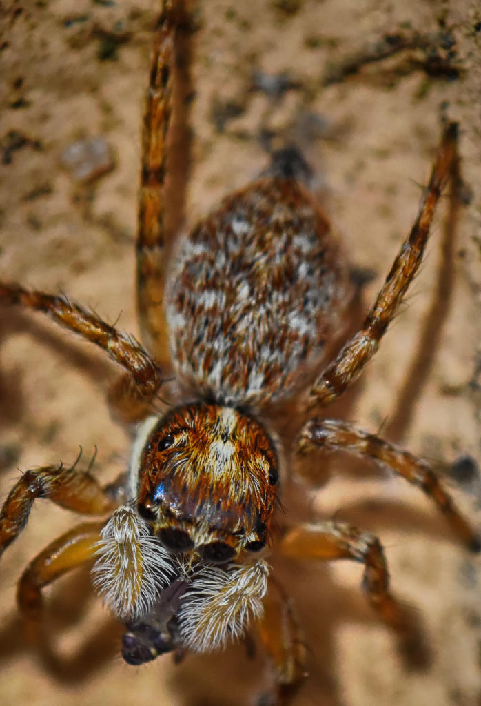

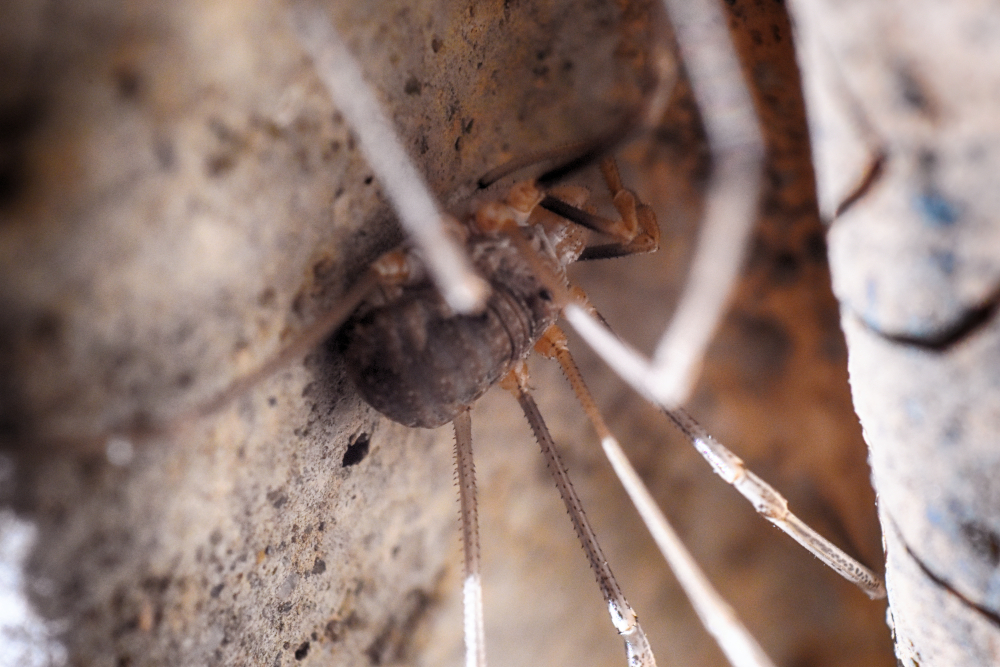

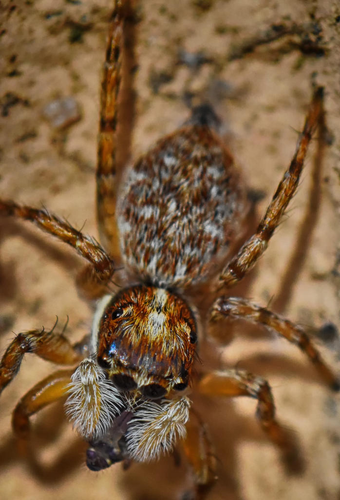

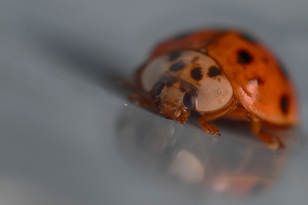

I realize lighting becomes non-relevant if shooting macro outside on bright or just sunny days :) But then everything outside moves voluntarily or forcibly... and too bad being a night owl unable to be up early morning to catch the moment most insects still prior to waking up. Anyway, I tried in mid the day. Found and pursued this lady for more than one hour. Made more than 50 shots all under hush and awkward situations. Only one shot barely achieved partial macro quality:
blackstar

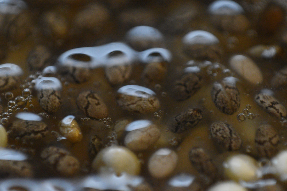

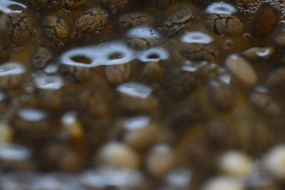

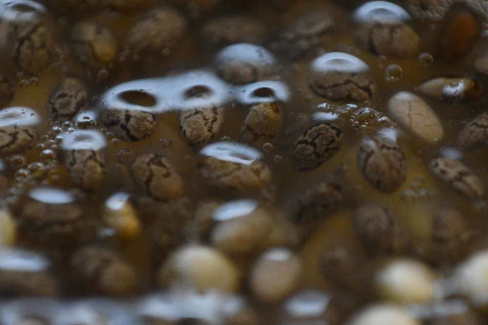

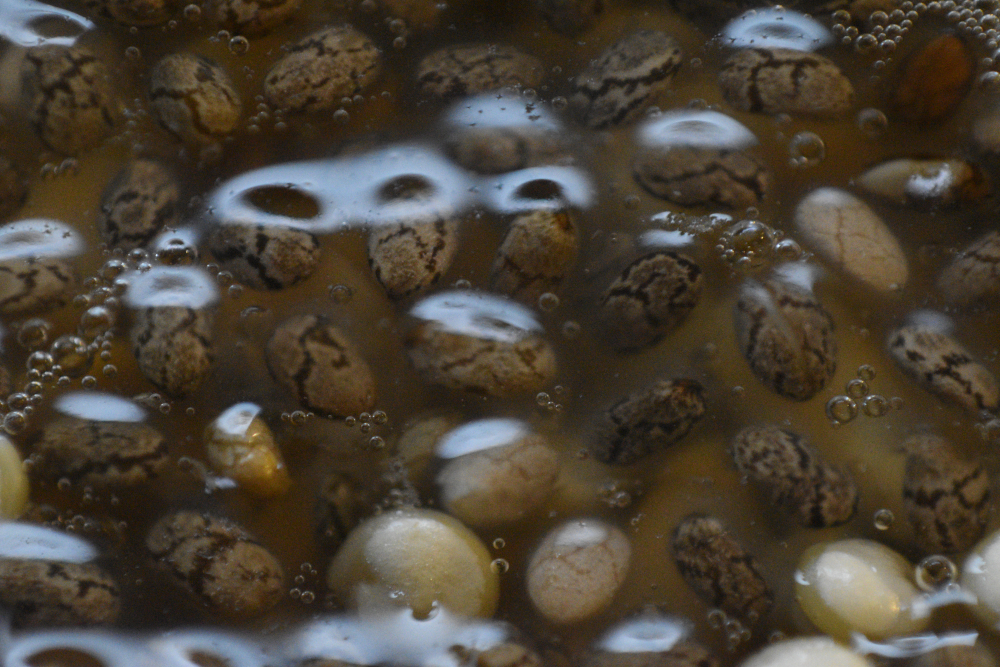

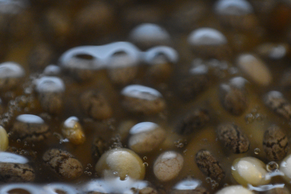

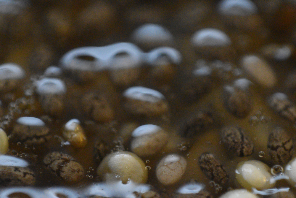

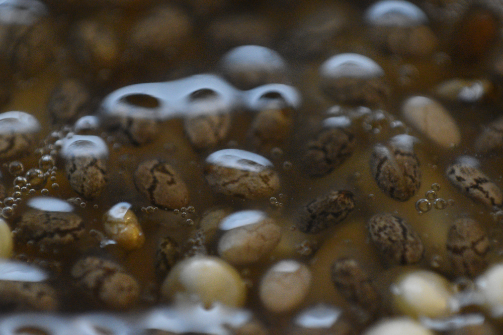

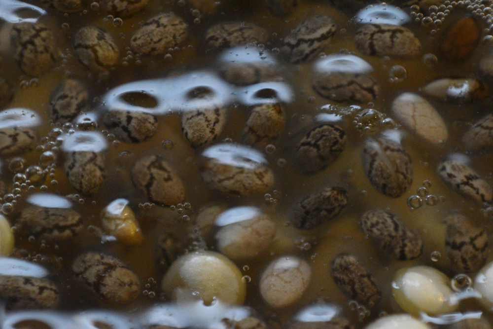

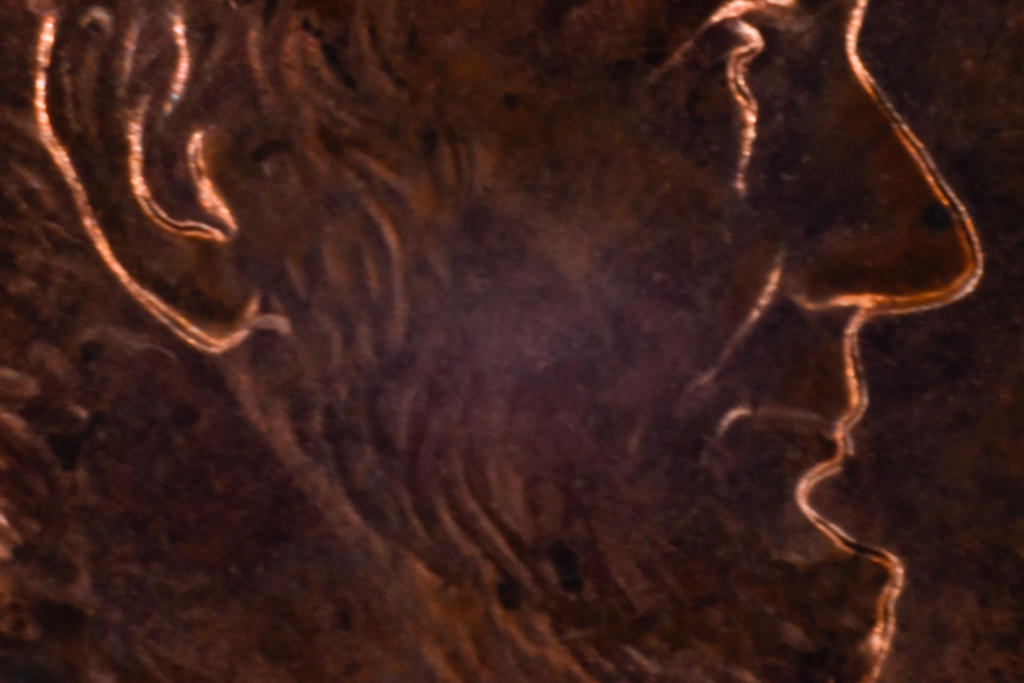

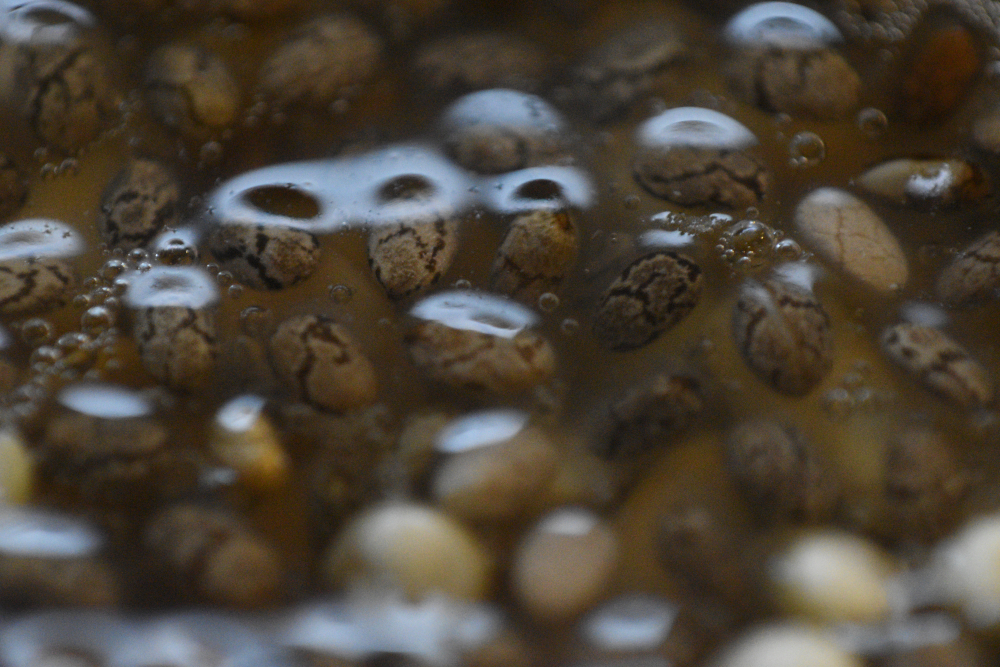

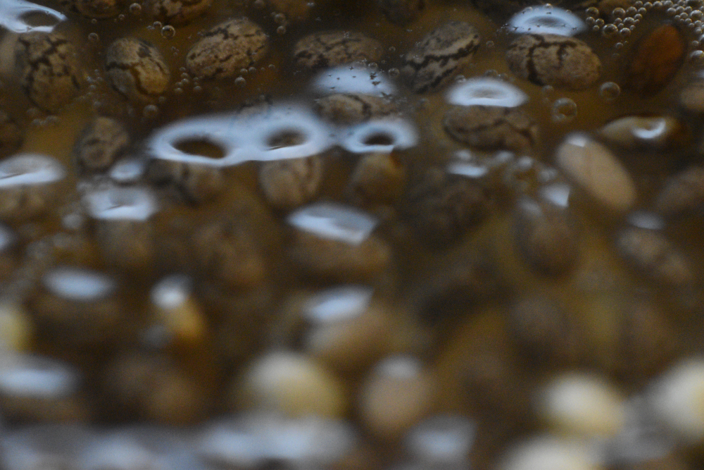

Another experiment: (This is not a close-up as stones in the water. It's real macro.) I had four single various-focus shots. Then used gimp to blend with layer masks (#5). Do you think, or rate how far it achieves focus stacking? Thanks
Dangerspouse
Well done! I think this focus stack came out very nice indeed. Your camera was on a tripod for those shots, I assume?
BTW, what are you using as the definition of "real macro"? Just curious here.
blackstar
DS, Yes, these shots were taken from on a tripod and inside. "real macro" should mean at least 1:1 magnification, I think?
**In case anyone wonders what subjects are in the photos? They are fermented quinoa and chia seeds.

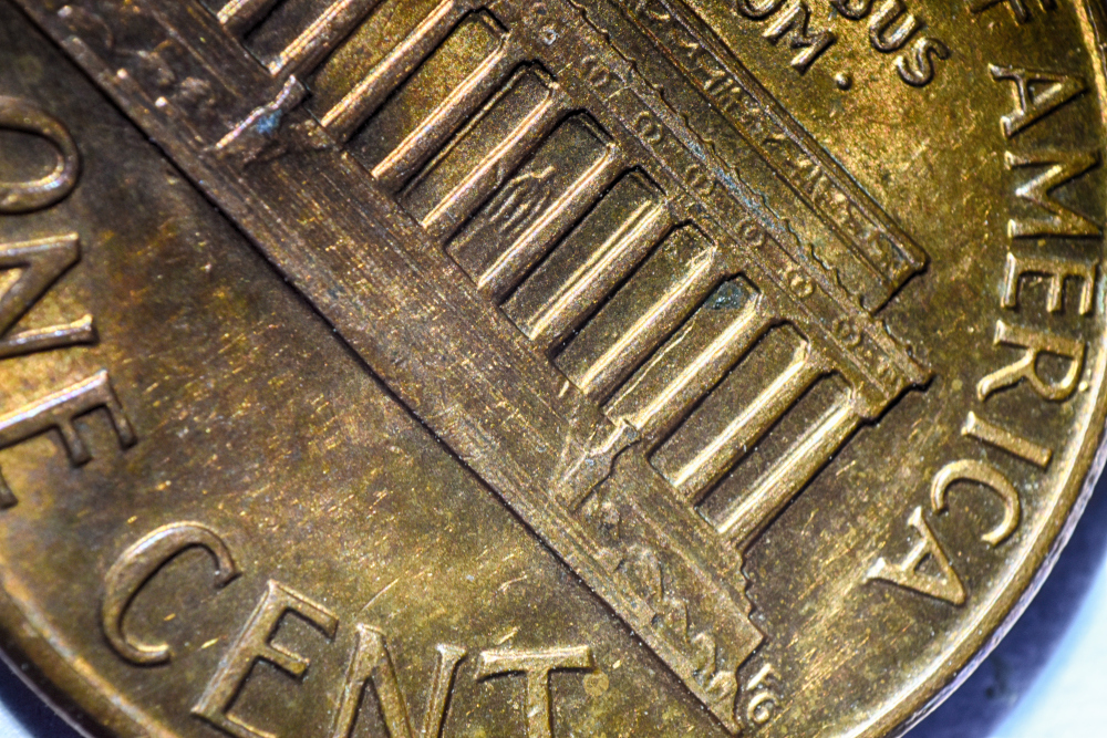

Hope this helped!

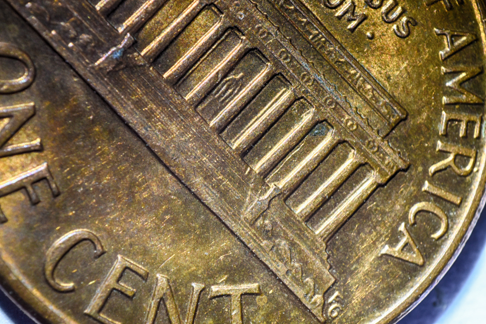

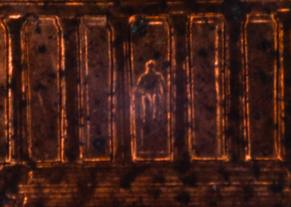

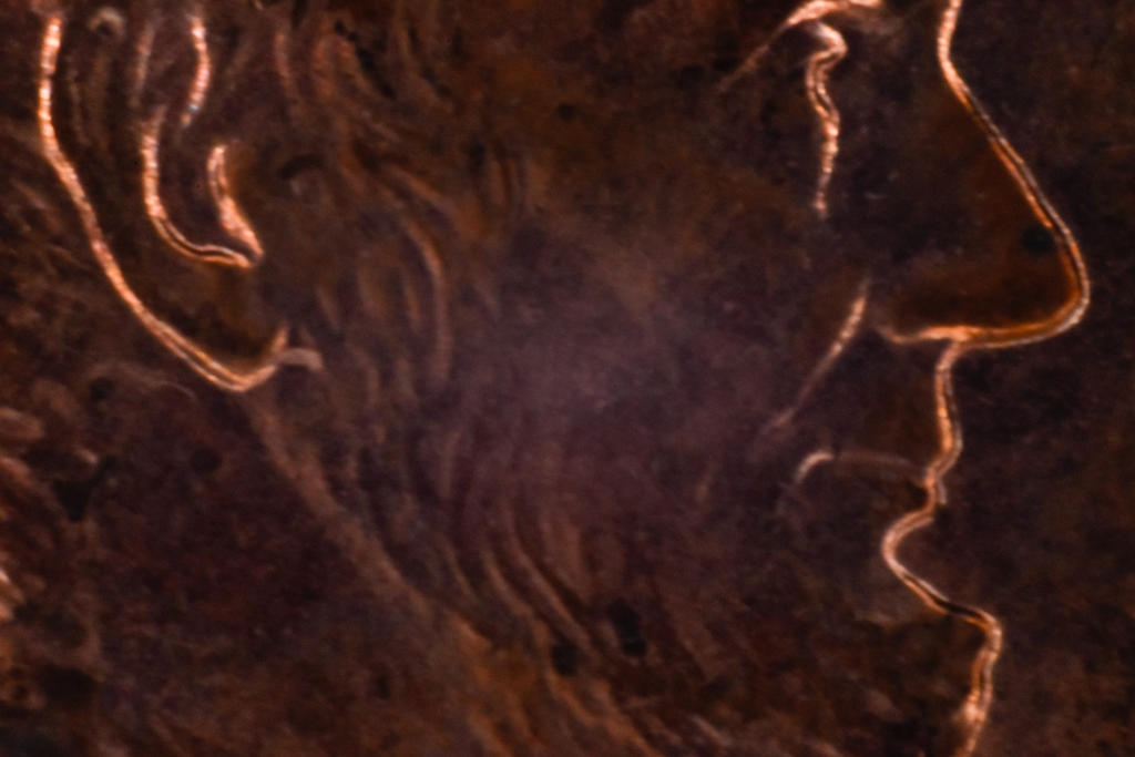

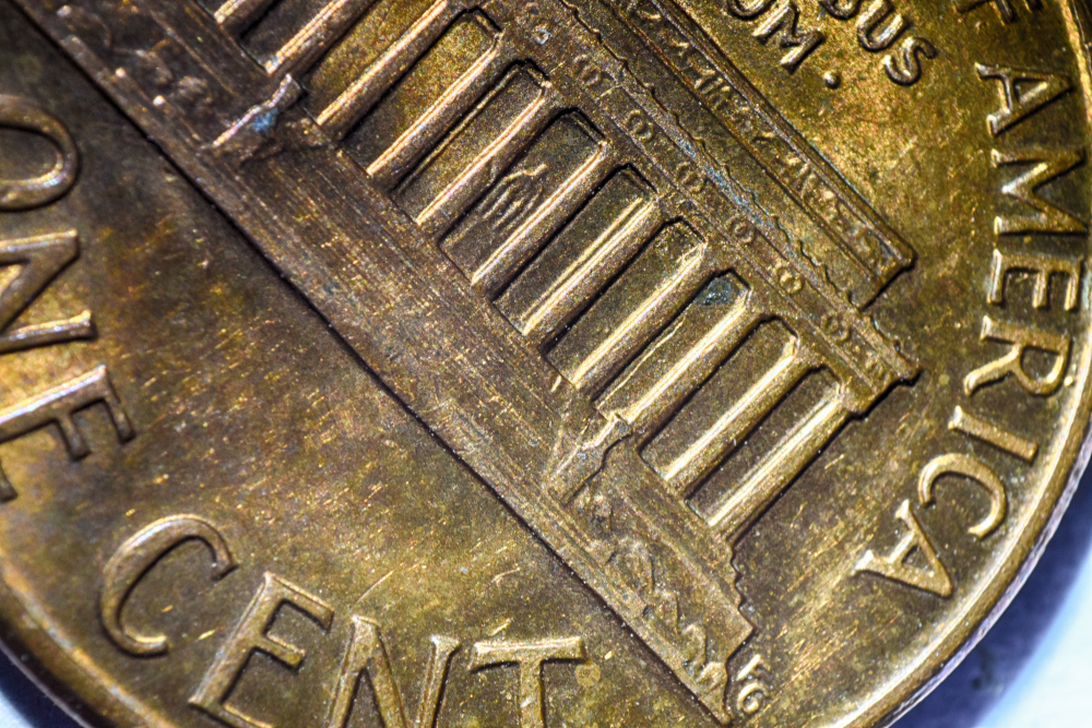

Hey DS, I made an effort trying copy your coin (penny) idea (see image below). It's true that I can't even notice Lincoln is sitting there with even glasses on my eyes! I recheck your settings (reverse same kit lens) and it looks like no significant difference except the camera sensor. But the outcome images have big difference in magnification. I didn't use extension tubes as if I did the shot would blow out like yours. So I wonder if you had used extension tubes?
Dangerspouse
Hi Blackstar - no, I didn't use extension tubes (I don't own any). This was just the kit 18-55mm reverse mounted, with a ring light. What focal length were you shooting at, do you know? I think I was at 18mm so I could get as close as possible, but I'll have to go back and check to be sure. Either way, that's a very nice shot you took. But yeah, the magnification difference is certainly pronounced.
