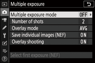

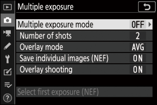

Are the settings you are using in Multiple Exposures the same for both the 5 and 7? I would bring up the Multiple Exposure menu in both and make sure they are identical.
The other thing I would check is that you have the latest firmware for both.
Here is the page for the online manual covering Multiple Exposure with the Z7ii. It gives a minimal explanation for all the different options in this mode. You may already have looked at this, but thought I would include it in case you find it useful.
