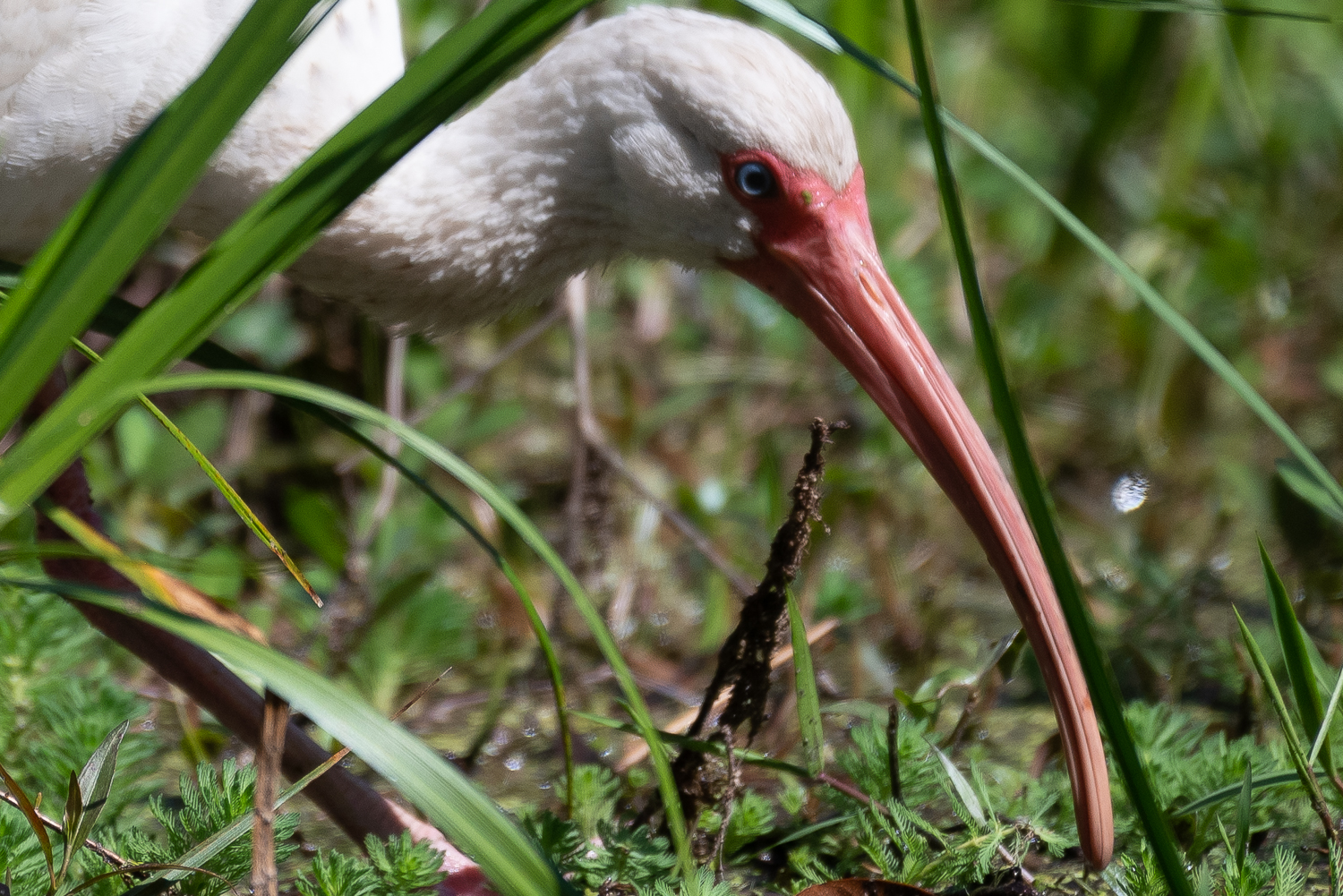

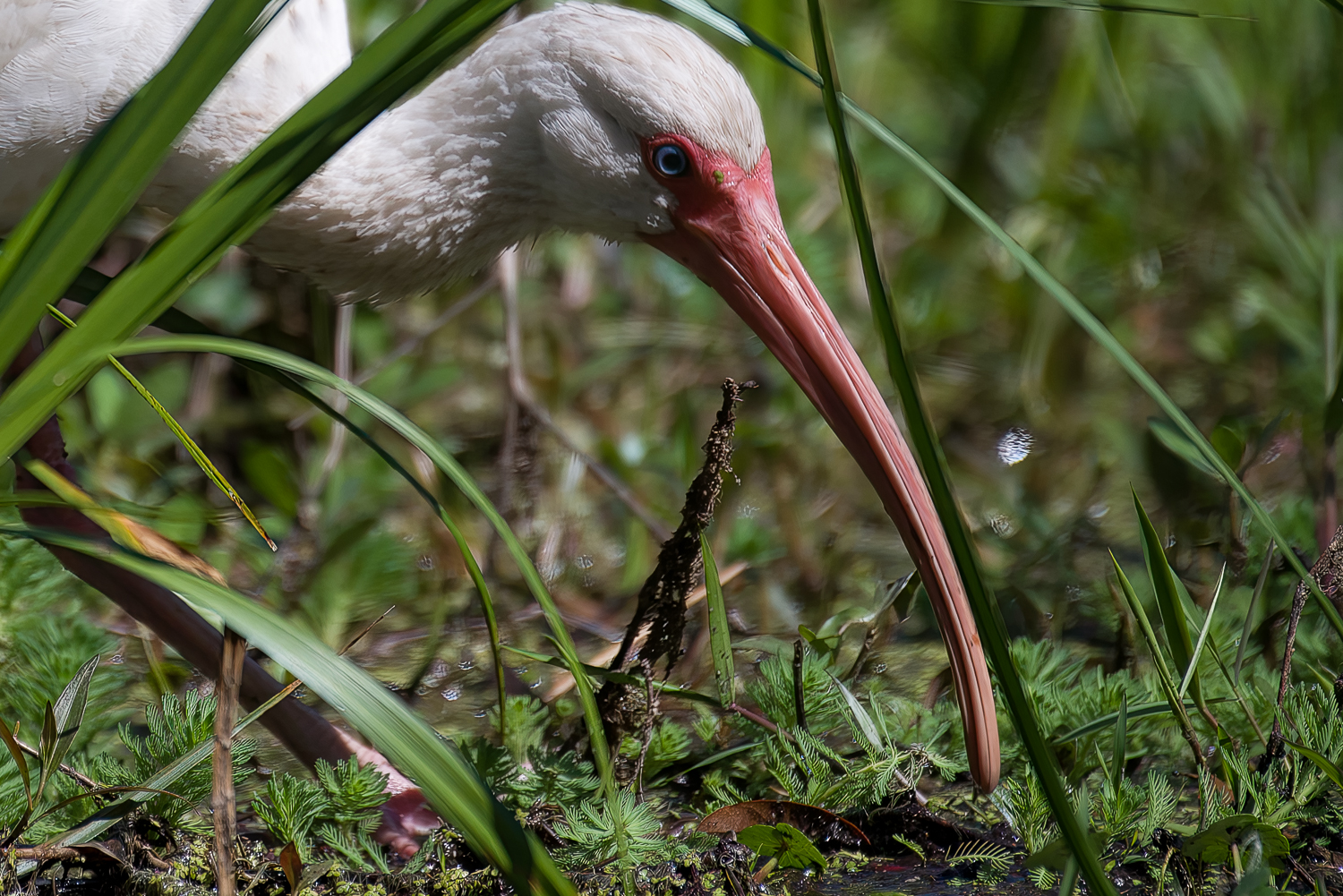

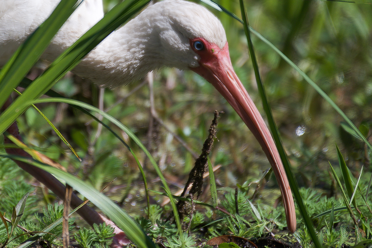

I am finding the programs to be a mixed bag. Worth the money, but they don't work well on all subjects and situations from my limited experience. I find that Sharpen AI is the least impressive of the three, and the one I had the highest hopes for. Here is a photo I picked because it wasn't quite sharp. I appears that the camera locked onto something other than the eye of the bird. It's not too badly out of focus, but too soft for use. It's not a terribly worthy picture for anything other than a test of the software. I ran it through the Sharpen AI software as an unprocessed NEF file. I then imported the Sharpened image and the original image into Lightroom and cropped them. One thing I noticed was that after running it through Sharpen AI, the image had substantially less contrast. I ended up adjusting the contrast, shadow and highlights to get the two photos to match as closely as I could by eye. I bumped up the sharpening in Sharpen to 50% to increase sharpness. I tried higher, but it started looking funky.
Here's the cropped, otherwise unedited image.
And here is the image after running it through Sharpen AI, and adjusting contrast, highlights and shadows.

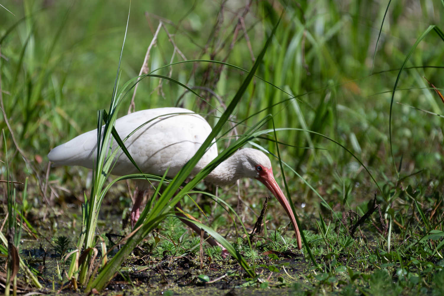

I'll let you decide on how well the program worked on this image. Just for reference, this is the full, unedited image.
Here is the unprocessed image with the sharpness slider at 116. For reference, LR automatically sharpens to 40 and maxes out at 150.

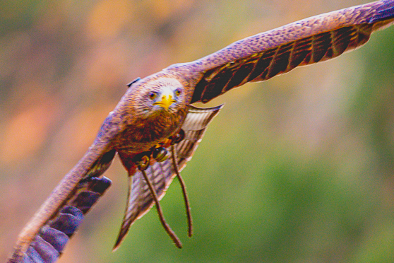

Tried, Email wouldn't let me send a file over 25 MB. LR and PS wouldn't let me resize and save as an NEF. At least I couldn't see a way to do that.
I did try Gigapixel on the image and ended up with this. No additional sharpening or editing in LR other than crop. Art was the only option that seemed to sharpen significantly.

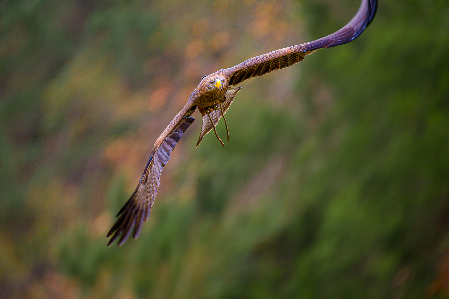

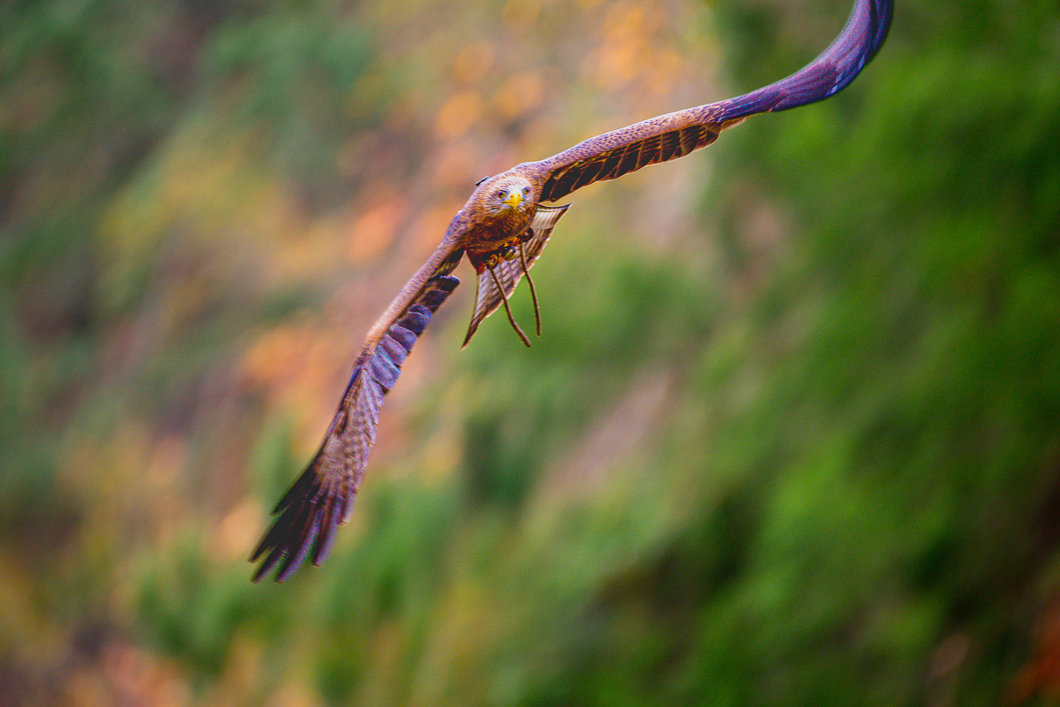

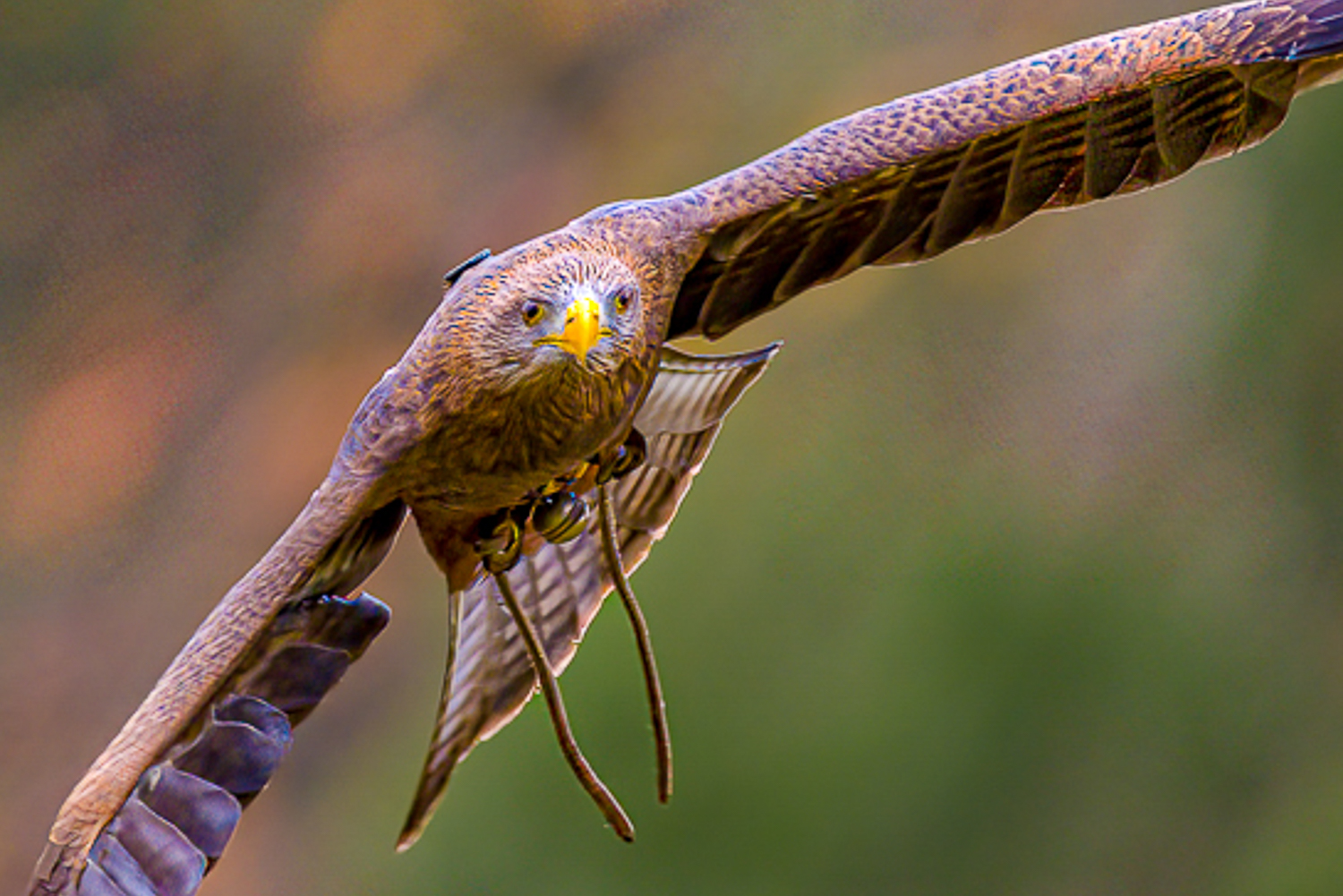

Thought I would try Sharpen AI on something else. I picked an out of focus BIF that suffered from motion blur.
Here is the image processed (badly, I didn't spend much time on it) in LR. I did add some sharpening to the bird only.
And here it is after running through Sharpen AI and then editing in LR. Note: this image was much easier to edit than the original.
The Sharpen AI version wouldn't do for a large print, but would be sufficiently sharp for an internet post. The first would not, even if I spent more time editing it to something better, the face is just too soft. As you can see by the cropped images, I didn't run the file through Denoise AI. Sharpen does some noise reduction, which I'm sure helped overall.
