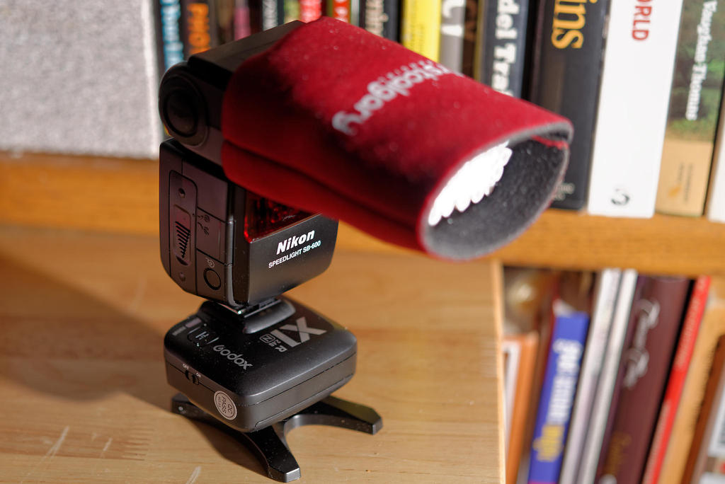

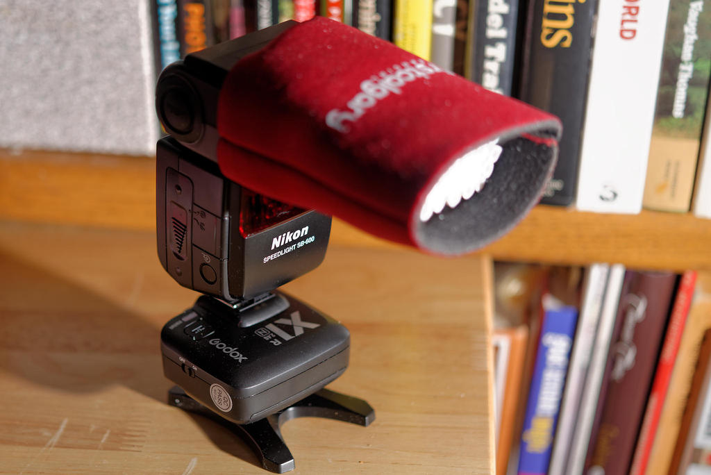

Slight variation on the theme here.
A "Beer Cozy" Grid
In this case a "Credit Union Cozy" Grid as the bit of swag I used came from a Calgary Credit Union.

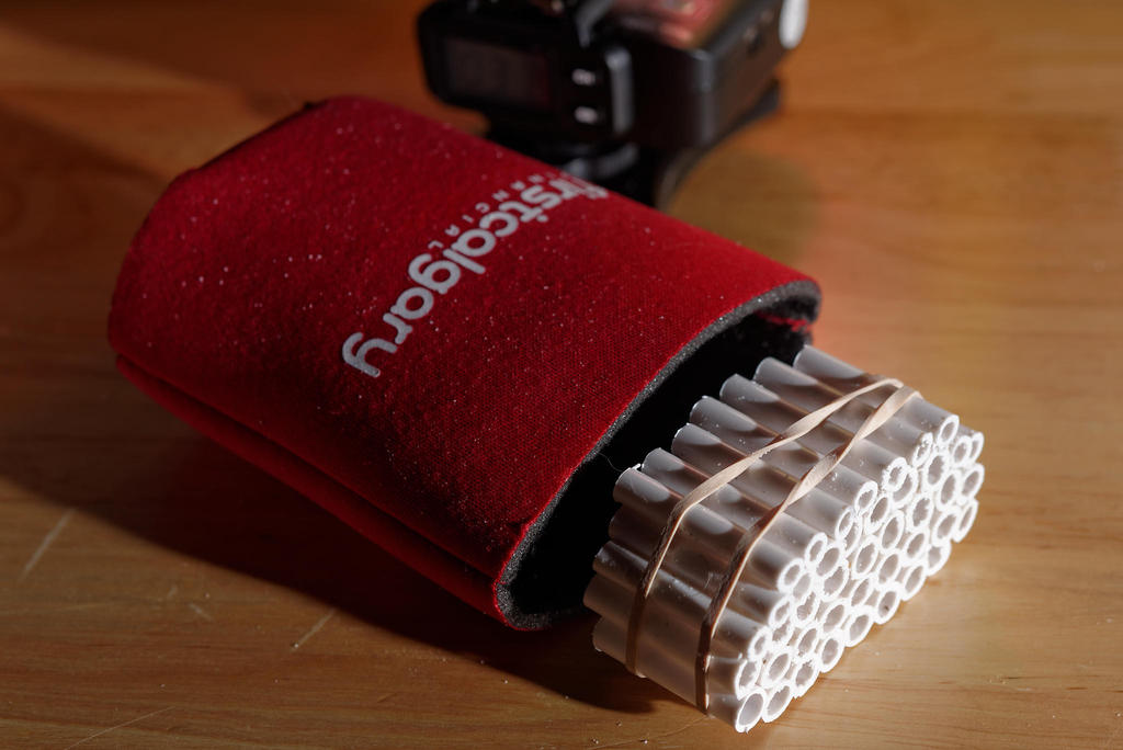

I used styrene tubes I had in my model railroading building materials box. But I suppose straws would work. Styrene glues really nicely though. (I'm sure crazy glue would hold straws - whatever works for you). The rubber band isn't holding the tubes together - it keeps the glued tubes from sliding inside the cozy. I suppose if I'd added another layer of tubes it would have been tight enough not to move inside the cozy. But the rubber band seems to do the trick.
Made my tubes 1" long - just because.
The cut the bottom part of the beer cozy out and folded it under - that made it fit snug on the speedlight.
