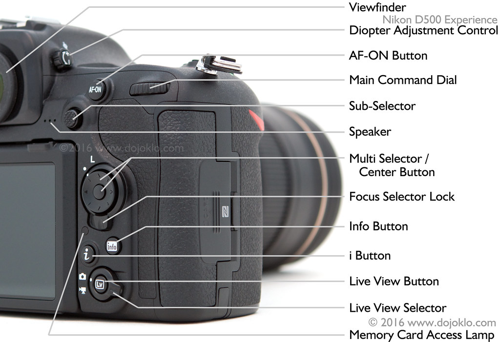

hark
In case you are still stuck (pun intended), here's a pic of the button/switch wev is referencing.
Do you see the switch for the Focus Selector Lock? If it's pointing to the 'L', then your focus point is locked. Toggle the switch to unlock it.
Pic comes from this link: https://www.flickr.com/photos/dojoklo/26832357493
