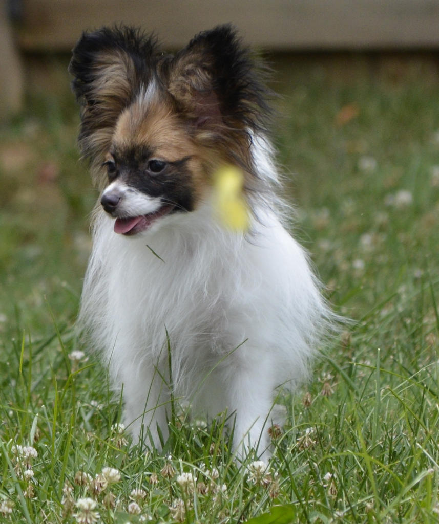

Ah, Costco was for many years my downfall :)... Today I took the camera outside and took about 100 pictures with an 18-200mm Nikkor lens. I got a strange anomaly on one photo. It is a yellow smudge appearing on the image. Can anyone tell me what this might be? I am going to try to attach the photo.

I tried earlier to post this but it has not popped up in the thread. I took some photos outside with the camera in question and a Nikkor AF-S DX 55-200mm lens. I found this anomaly on one of the images. Does anyone know what this is? If camera related, that is fine because the camera is going back. But was planning to keep the lens which is new.Anomaly.jpg
Bikerbrent
Can you try the lens on another camera? maybe even at a camera store. If not, I would look very carefully into the back of the lens to make sure none of your yellow goo splashed on the lens. If it did, your should be able to clean it. I suspect the yellow on the photo is your yellow goo that dripped down onto the sensor. Is so, since the camera is going back, not a problem.

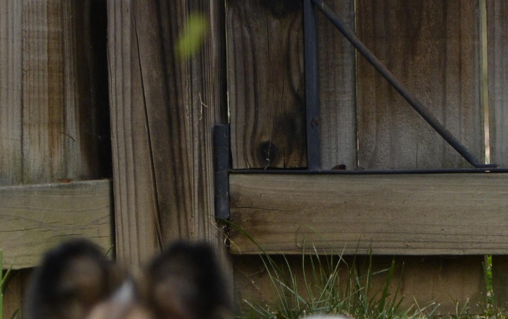

Thank you. I looked at the lens and it is OK. I also just found this, a yellow anomaly on the upper left corner, and the smudge is translucent. I think you are right. yellow goo :(. Ah well, at least I can return it and still use the other gear I bought. Will be looking for its replacement. Anomaly2.jpg
